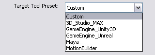

In the Export FBX panel, use the Target Tool Preset drop-down list to auto-load the settings
for your target 3D tool.
Please refer to The Settings for Exporting an FBX File section for more information
about the details of this setting.

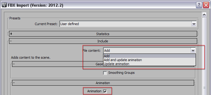

Import the FBX file into your target 3D tools (Maya, 3DS Max,
Unity or Unreal) with the settings below:

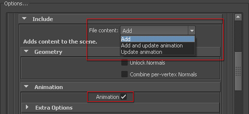

Maya (FBX plugin 2012.2 version or above)
Select the Add item from the File content drop-down list
in the Include section.
Activate the Animation box in the Animation section to import the included
animations in the FBX file.
3DS Max (FBX plugin 2012.2 version or above)

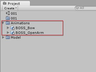

Unity: No specific settings need to be done. However, the geometry and the animation files must be
individually imported.
Because the animations are isolated into different FBX files, you need to import them into the
project panel respectively.
