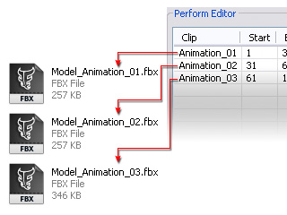

Step 2: Export Animation-Only FBX Files
In this step, the animations of the model will be exported into separate FBX files. The number of the files are the same as the amount in the Perform Editor.
  1. Deselect the Include Geometry box and select the Include Animation box, and select the Save One Take Per File option.
  2. Click the OK button to export the animations of the model into different files.
The geometry and the animation files can then be loaded into Unity or Unreal separately, which will ensure the correct animation result.
