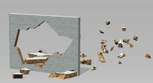

| A-3 |
Activate the Explode command in order to see the interior that you want. |
Sample: |

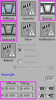

| B.Adjust the Offset / Tiling setting in Material & Texture Settings. |

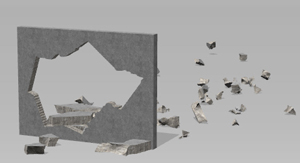

After the materials are changed, you may need to adjust the Offset / Tiling setting.
Adjust the Offset / Tiling setting in Material & Texture Settings, and you will see the final result.
Note. Due to the destructible iProps are made of many fragments, we suggest that do not adjust |
the settings as below. |
a) Refraction/ Reflection. |
b) Opacity Channel. |
