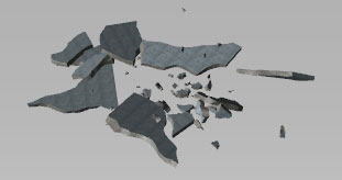

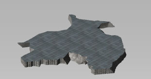

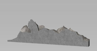

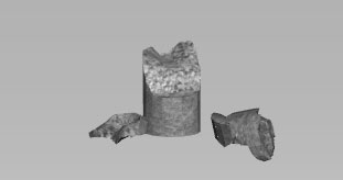

You can repeat the step A & B to produce these debris as below. |
