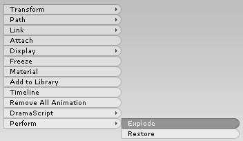

  Select Brick Pillar 1-5 in the Scene Manager and right click to activate Explode,

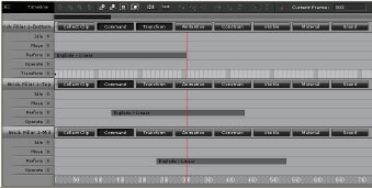

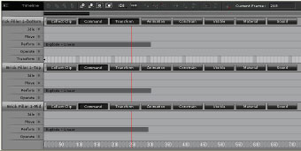

A-2 Flexible Adjustment.
  Pillar 1-Plus and 2-Plus both include three explosion points (Top/Middle/Bottom) that can be selected. Below is how to.
  Apply Brick Pillar 1-Plus.
  Select and Rotate the part (eg. middle ) via transform tool to change its explosion direction.
  Select Brick Pillar 1-Mid in the Scene Manager and right click to activate Explode, and wait for the Animation to be generated.
  You can activate the other parts at a different time.
  You can adjust their explosion time in the Timeline. (Explode continuously or simultaneously ).

  Select Glass 1_1-1 in the Scene Manager and right click to activate Explode, and wait for the animation to be generated.

C-2 Select Double Door-1 in the Scene Manager and right click to activate Explode, and wait for the
