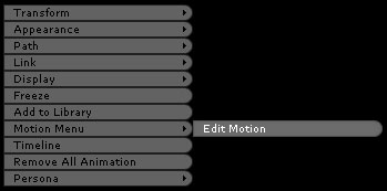

A-2. Right-click on the Creature Base and select Motion Menu/Edit Motion.

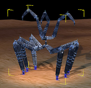

B-1. Select Move tool in the Control Bar.

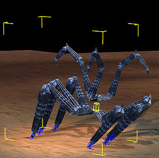

B-2. Hold down Ctrl key and click on the feet of the robot They will be marked with blue boxes as below: The blue box means that the selected bones will be nailed.

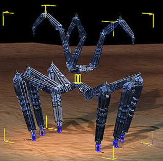

B-3. Pick the '' LowerBase'' of the creature base as below. Drag LowerBase, and you can edit poses easily.
B-4. Use the method mentioned above in the timeline to edit the animation that you need. If you need more information about IK/FK, please click here.
