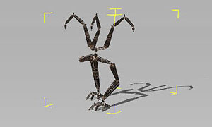

A-1. Apply any robot (Ex. Biped Robot_Skinned).
A-2. Go to Actor/Persona, apply Persona (Ex. Biped_Robot).

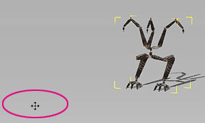

B-1. Move the robot in Editor Mode: Choose the robot, right click and choose the command in the Move menu.
  Click on the location that robot will move to, and robot will start to go there immediately.

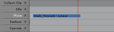

  Press W or S, robot will start to move forward/backward.
When you press A or D, robot will turn left/right.
  You can check Auto add idle. When robot is not moving.
It will perform idle motions automatically.

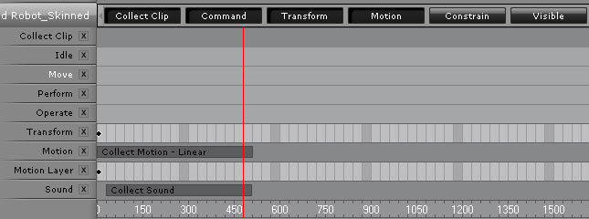

  Tips. In Director/Editor mode, the corresponding sound effects will be generated automatically.The sound effect will move when the Motion Clip moves in the timeline.
  Please see below if you want to delete the sound effect.
Choose the motion clip, and press Collect Motion.
  There is a sound Clip in the Sound Channel, you can select and delete.
