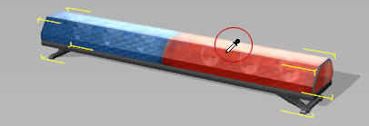

Load Siren_Light_B.iprop |
| Execute the Pick Material function, and choose the area that will glow. |
Make a Glow Texture (In this example, the prop has a Glow Texture already). |

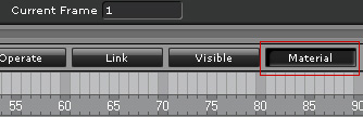

| 1. |
Open the Timeline/Material Channel. |

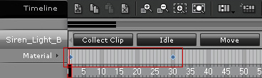

| 2. |
Switch to Frame 1, Use Pick Material to choose Red Material/Glow, and set the value of Strength to 100.
Use Pick Material to choose Blue Material/Glow, and set the value of Strength to 0. |
| Use Pick Material to choose Red Material/Glow, and set the value of Strength to 0. |
| 4. |
Use Pick Material to choose Blue Material/Glow, and set the value of Strength to 100. |

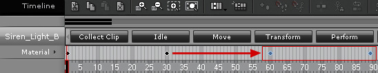

Drag and copy the adjusted Materials like below. |
| Choose Frame 1-30 on the Timeline/Material. |
| Keep pressing the Ctrl key and drag to 60 Frame. |
| 6. |
Drag and copy multiple times based on your needs. |

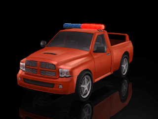

| 7. |
The flashing light is complete. |
