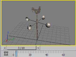

Step 1: Loading a Model with Animations
Although the model may contains no bones, by transforming the meshes, the model can also has animations.
The sources of the boneless models can be:

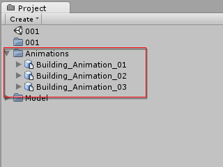

Unity: No specific settings need to be done. However, the geometry and the animation files must be
individually imported.
Because the animations are isolated into different FBX files, you need to import them into the
project panel respectively.
