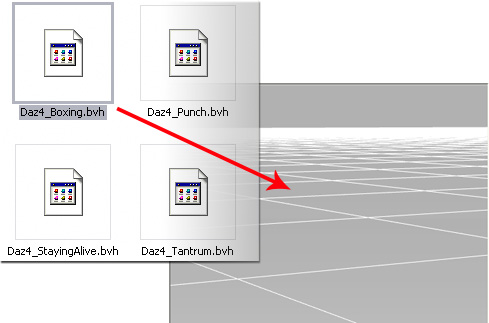

  2. Press Ctrl + N to open a new project.

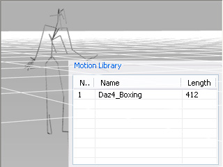

  3. Load one of the motion files into the 3D viewer. Because the motion file contains no character meshes or bones, 3DXchange will automatically generate stick-shaped meshes for better viewing.
  4. 3DXchange generates a stick man for you to observe the motion. The motion file will be put into the Motion Library.

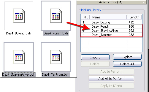

Once the environment is set, you may start to load multiple human motion files into the Motion Library of 3DXchange.
  1. Select the rest of the motion files in the browser. Drag and drop the motions into the Motion Library in the Animation section of 3DXchange.

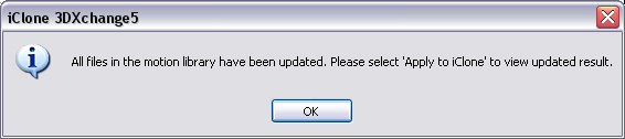

  2. Click the Convert to Non-Standard button in the Character section to characterize the motion.
  3. Once the characterization procedure is complete, click the Convert button to leave the Characterization mode. You will be then prompted with a message that all motions in the Motion Library are converted.
