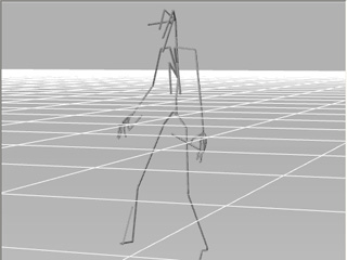

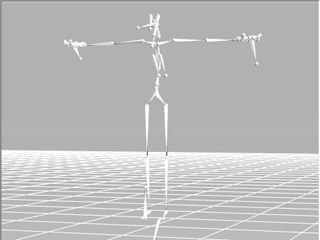

Load a character motion file in the formats described above by drag-and-dropping the file directly into the 3D viewer. If the file contains no character mesh, then
3DXchange will apply a stick character for observation.

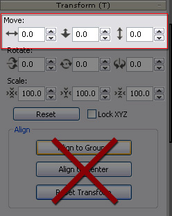

Adjust the X, Y, Z values in the Transform section so that the
motion will be relocated to the center of the world. Please not that you Must Not use the Align to Ground,
Align to Center or Reset Transform button to change the position of the motion.

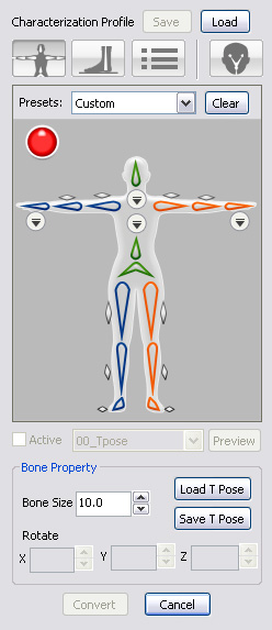

Go to the Character section of the Modify panel.
Click the Convert to Non-Standard button to enter the
Characterization mode.
The Modify page will instantly change to characterization mode.

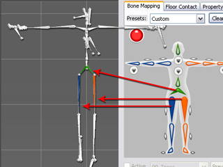

Step 3: Mapping Motion Bones to Reallusion Human Bones
Converting a custom motion to an iMotion in 3DXchange is actually
mapping the custom bones to the standard bones so that when the motion is
applied, the character is triggered to act by the standard bones to which
the motion is actually applied.
Motions from Standard Bone-rigging 3D Tools
Motions from Custom Bone-rigging 3D Tools
Note:
When you load a motion file which only contains bone relation without mesh data;
in order to show the character structure, 3DXchange adds in
mesh nodes with a suffix name _AutoMesh as visual dummies to
represent the character.
Please note that you must always map the bones instead of the mesh nodes with suffix name _AutoMesh
to prevent incorrect mapping results.

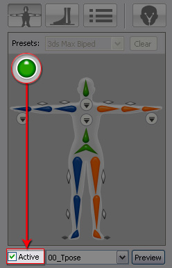

After finishing with the mapping, enable the Active checkbox so that the
motion bone structure is governed under the
RL Bone.
Click the Convert button to exit the Convert to Non-Standard mode.

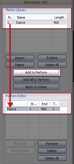

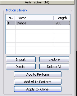

Go to the Animation section, select the motion in the Motion Library section.
Click the Apply to iClone button to apply the selected motion and preview the
motion results.

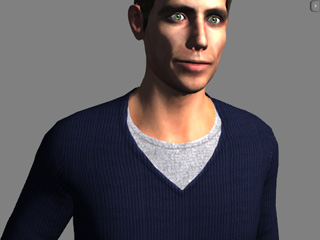

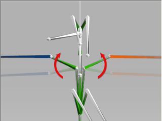

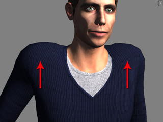

If the character shows some motion flaws, such as shrugged shoulders, then you need to adjust the T-pose in 3DXchange.
The motion shrugs the character's shoulders in iClone.
Rotate the collar bones to align to the motion.
The shoulders are rectified.
Repeat the steps until the motion results appear to be correct.
Step 5: Saving Characterization Profile and Export
If you are satisfied with the motion results, then enter the Characterization mode and
save the settings as a Characterization Profile to reuse later.
Leave the characterization mode and click the Add to Perform button to add this motion to the Perform Editor.

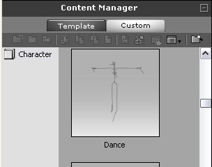

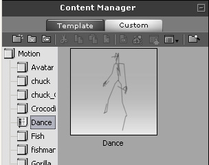

Export the mapped motion to use inside iClone as a
Standard Character Motion.
Export with Geometry and Animation boxes activated:

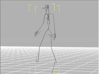

The stick man built up with auto meshes will also be exported as a non-standard character.
The motion is put into the Custom Motion library under a folder with the same name.
