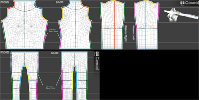

Template Map
Outer body garment mesh texture template. The Minimum Bleed Area in the UV reference image indicates you where to paste and fully overlap your cloth onto it. This can prevent the result from image-distortion at the side
seam of the outfit.
The edges of the same color contour lines will later be sewed together.
  Texture Template - Applies to Upper & Lower Textures.

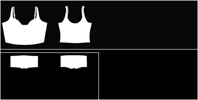

Opacity Map
  Black = hide cloth
White = show cloth
% of Gray = sheer cloth
How the map works with the Template Map

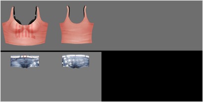

Diffuse Map
  Add texture and graphic design to clothing.
