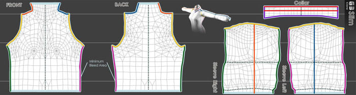

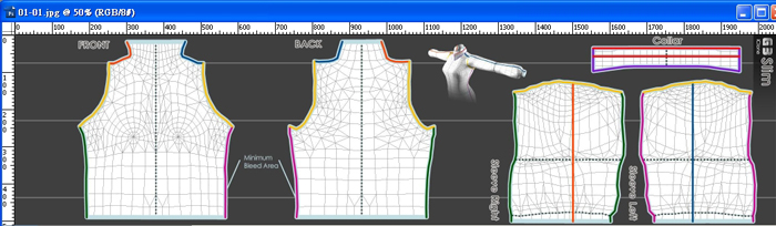

The Minimum Bleed Area in the UV reference image indicates you where to paste and fully overlap your cloth onto it. This can prevent the result from image-distortion at the side seam of the outfit. |
The edges of the same color contour lines will later be sewed together. |

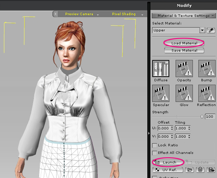

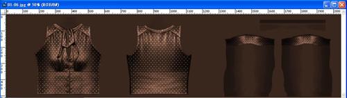

1.How to create an upper clothing? |

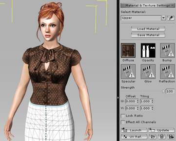

3.Save as a Material file |
If you want to use the same clothing again, you can simply press the Save Material button to export the material for upper body, so you don´t have to import images for each channel. Instead, you can simply apply the .iMtl file. |
