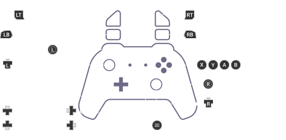

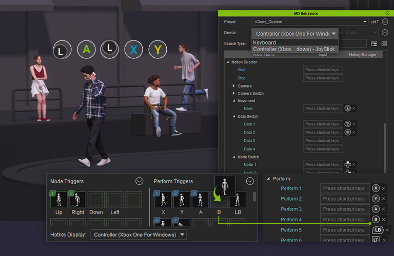

The most enjoyable way to steer your characters in iClone is by game controllers.
Custom Hotkey & Trigger Actions
Apart from moving characters around, you can also trigger the character to perform certain actions with the keyboard and gamepads by setting hotkeys in Hotkey Manager.

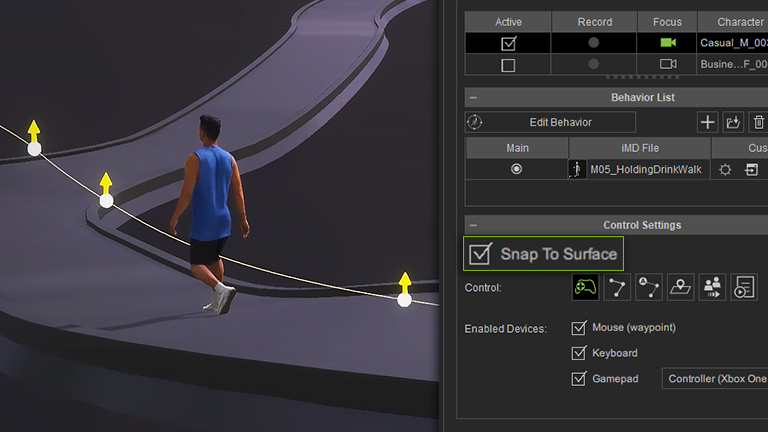

Under Control On Path and Auto Path mode, you will need to designate a target path and adjust relevant settings like whether to start the motion on path, and the idle/walk/speed change ratio.
Similar to Path Mode, you will need to designate a target zone and adjust Action Settings for the activeness of the character when moving within the designated zone.

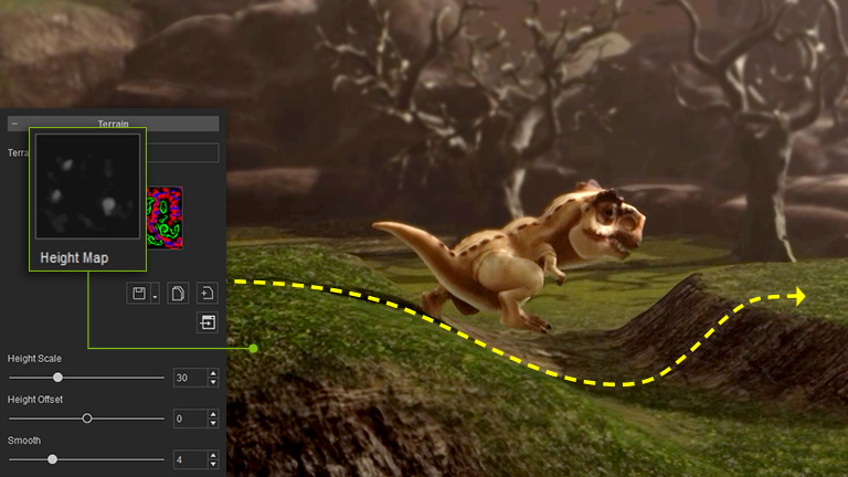

Works for uneven mesh from displacement maps, and photogrammetric seamless textures created with the Nature Terrain Generator plug-in.
Note: NOT supporting Water and SpeedTree.

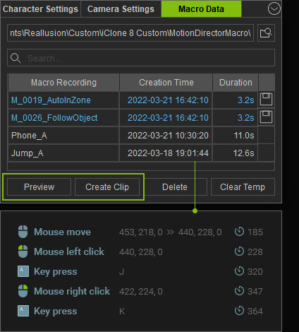

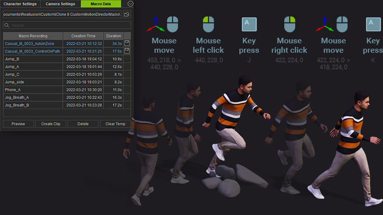

Macro Data

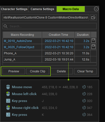

Everytime Motion Director is used, characters that are activated will have their control sequence recorded. The event data is small in size and saving is required for Macro Replay.
Macro Replay Control
Use Macro Replay to string together several history macro segments, no matter where you place your actor, it can simulate the keystroke or controller events and animate your actor right from the new position and angle.

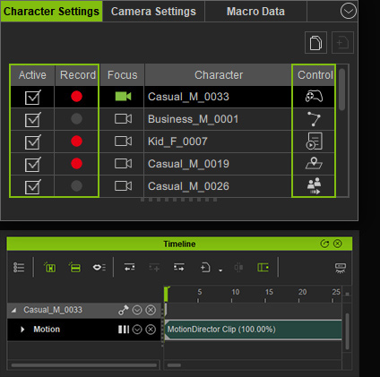

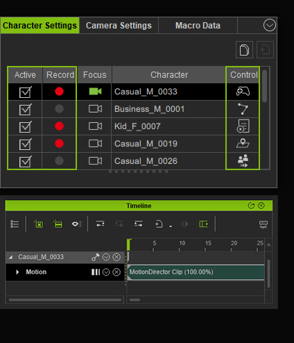

After learning how to control character motions and camera views during runtime, place the clip that is created with Motion Director to the iClone timeline so that it can be exported. Here we have three ways to record to timeline:
1. Motion Record
Click to enable recording for each character motion.
2. Macro Data Record
You can directly create the Macro Data clips to your timeline, without the need to record the replay sequence.

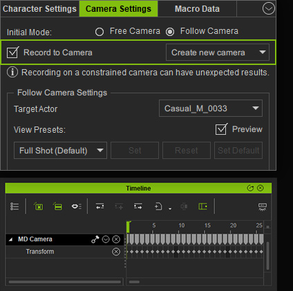

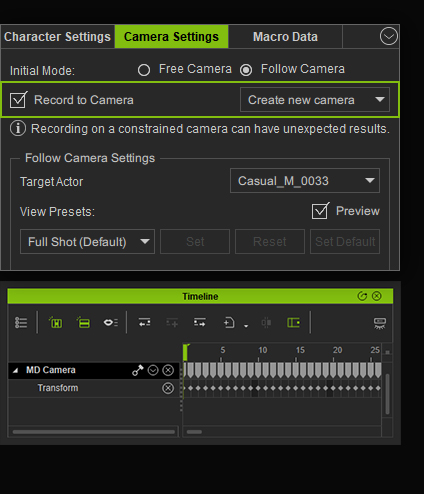

3. Camera Record
Activate 'Record to Camera' checkbox and your camera movements will be recorded to the selected camera and its timeline.

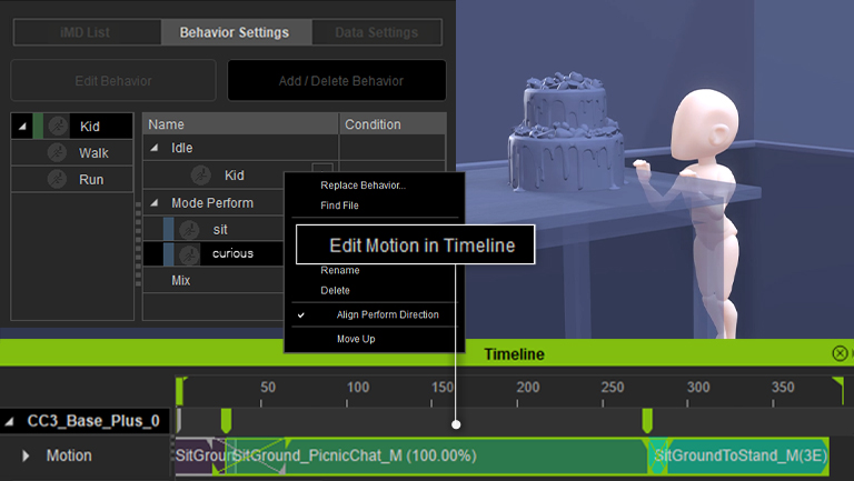

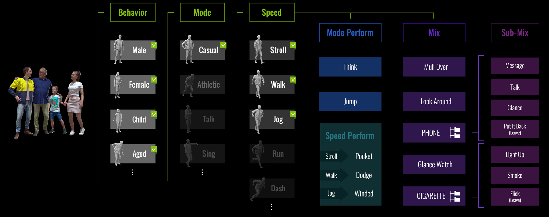

Motion Director is designed to let users freely expand AI controllable behaviors with the following structure in mind. We will keep collaborating with professional mocap studios producing expansions in different styles and themes, and plan to open the custom creation capabilities to users in the future.
The Motion Director provides the followings for your first experience:
It's easy to apply new motion behaviors to characters with a simple drag and drop from MD motion library, and more MD options such as Talk, Dance, and Social Interaction are being planned for expanding the MD behaviors in the future.
