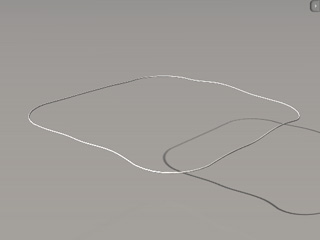

  1. Apply a curve track and transform it to a ideal size. Set it as a Static rigid body (the Bound Type is Self Mesh).

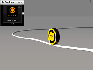

  2. Apply the Motor A and transform it to contact above the track. It will later be the wheel.
  3. Play to simulate and the motor rotation. It will spin in one place because it is constrained to the World (Press Shift + F10 to view the constraint of the motor).

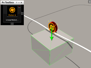

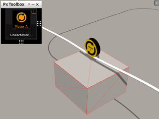

  1. Apply a box from the 3D Blocks library and position it under the track. Set the box as Dynamic rigid body.
  2. Select the motor again and pick the box as its target.
  3. Click the play button on the Physics Control to begin the simulation, and the structure will fall as soon as it climbs a slope or turns on the track.

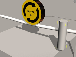

  1. Go back to the start frame and apply one cylinder. Position it above the box and as close to one side of the track as possible.
  2. Set the cylinder as Dynamic rigid body and set the Bound Type and Bound Axis to (Cylinder, Z).
  3. Switch to the Local Move tool to observe its pivot direction.

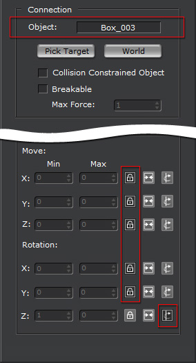

  4. Press Shift + F10 to show the constraint panel.
  5. Apply a Generic constraint to the cylinder and enter the specifications shown below:
    • Set the connection to the Box.
    • Set the X, Y, Z in the Move section to (Lock, Lock, Lock). The cylinders are fixed to the box.
    • Set the X, Y, Z in the Rotation section to (Lock, Lock, Free) so that the cylinder is able to rotate around its Local Z axis.

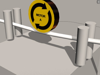

  6. Make three copies of the cylinder and position them on each side and as close to the track as possible.

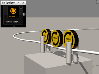

Removing Scripts and Merging Control Panels - Adding More Motors
Because the track has ups and downs, to allow the structure to be able to proceed smoothly, you may need to add more motors in order to give the structure stronger moving power.

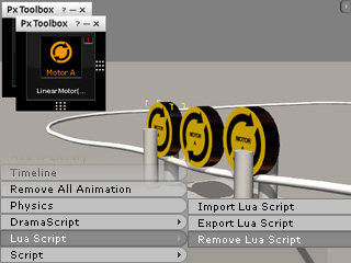

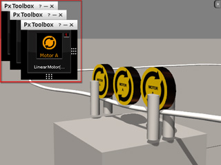

  1. Duplicate two more of the motors. Line them up. You may notice that the Control Tile Panel will also be duplicated twice.
  2. Select one of the two new motors and right click one it, select the Lua Script > Remove Lua Script from the right-click menu to remove its control tile panel.
  3. Remove the control tile panel of another motor as well so that there is only one tile panel left.

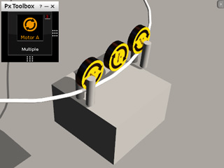

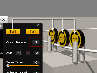

  4. Open the Advanced Settings panel of the control and use the Pick function to select the two motors whose control tile panels are removed, so that you are now able to control three motors with a single control.
  5. Play to simulate the physics result.
