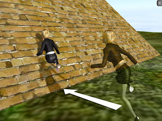

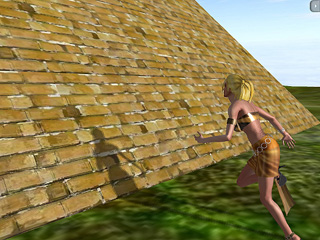

  4. Go the start frame of the project, and apply a "Run" motion to the actor.
Snap to Terrain is on but the Align Actor Motion is OFF.
The actor runs through the terrain.

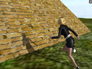

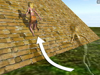

  3. Go to the start frame of the project, and apply the same "Run" motion to the actor.
Because the Actor Root is affected by both the Snap to Terrain and the Motion Root at the same time, the latter actor will run along the terrain.
Snap to Terrain and Align Actor Motion are ON.
The actor root snaps along the terrain.
