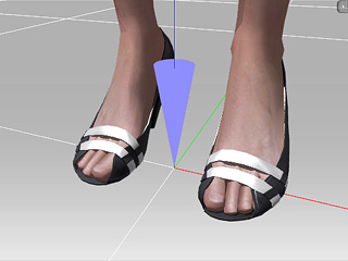

The Actor Root (BoneRoot, Pivot) |

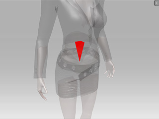

The Motion Root (LowerTorso) |
Actor Root: It is also known as the BoneRoot or the Pivot of the character, which determines the actor's actual location, i.e., the value of the transformation data (Move, Rotate).
Actor Root changes only when transformation is being applied in
the Editor Mode, WASD or right-click menu/Move command is used in
the Director Mode. The data is kept on the Transform
track. |
Motion Root: It is also known as the LowerTorso node in the actor's bone hierarchy. All applied motion clips affect the transformation change of this node, thus you might see kick or dance motion. However the Actor Root remains in the original position.
All motion clips, either from the Content Manager or from the Import feature, are kept on the
Motion
track. |

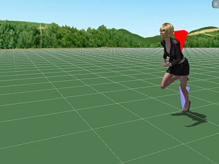

A "Run" motion is applied to the Motion Root. |

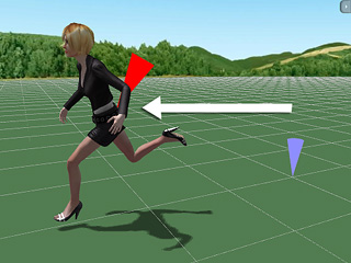

The motion clip brings the Motion Root away from the Actor Root. |

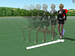

If the Auto Add Idle Motion is on, you might find the motion being dragged back to the Actor Root, because the Actor Root is still there, and the idle motion always aligns with the Actor Root. |
