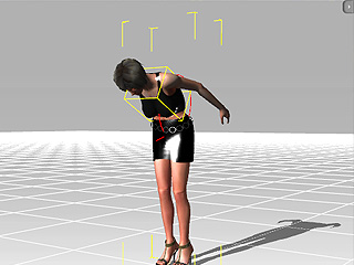

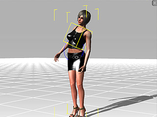

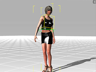

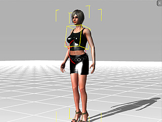

In the Edit Motion Layer panel, pick the upper torso effector point.
Drag your mouse or roll the mouse wheel on the 3D viewer.
Note: |
You may toggle among rotation axis by right-clicking in the 3D viewer and then either drag on the 3D viewer or roll the mouse wheel to rotate the selected bone. |
Right-click to change the axis and drag or roll the wheel to adjust offset position. |
