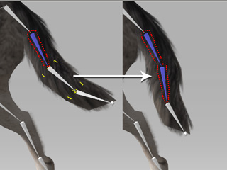

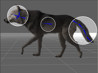

3DXchange provides a simple method to set the overall spring effect of a spring group with sliders. You are also able to re-arrange the spring strings so that they can be included in the same group, in order to form custom spring tracks and simultaneously set spring keys at different times in iClone.

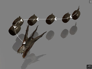

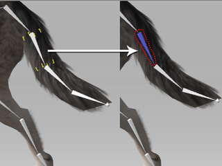

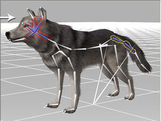

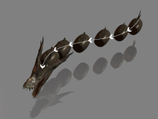

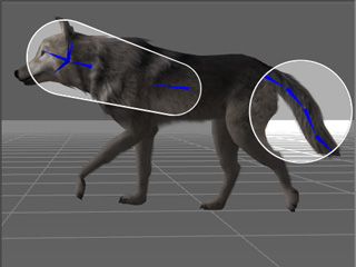

Spring Chains and Element Nodes
Group Settings

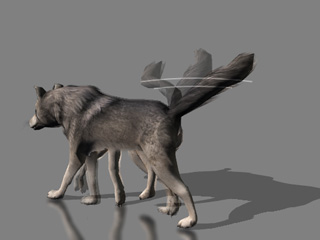

The Group Settings determine the overall spring effect for every spring chain(s) in the group, the elements in the string thus multiply the Soft and Hard values within the Mass, Strength and Bounciness values.
Group Settings
Managing Spring Groups

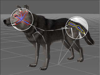

You are able to manage spring chains via the Spring Group Definition panel. The benefit of doing so is that this is a quick way to share the Group Setting Values (Mass, Strength and Bounceness) and to build a single spring track editing entry.

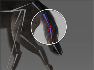

Combining Spring Chains into One Group

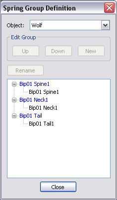

  1. Select any bone node that has been given a spring effect.
  2. Click the Spring Group List button at the bottom of the Group Setting section in the Modify panel.
  3. The Spring Group Definition panel appears.
    1. The blue nodes in the list are the group name. It will be shown as the track name in iClone.
    2. The black nodes under the root nodes are the name of the spring chains.
  4. Select one of the spring nodes and the Up or Down button in the Edit Group section will be enabled.
  5. Click the Up or Down button to move the selected node to another group name.
  6. The two spring chains now share the same group settings as described in the previous section.
Separating Spring Chains from Group
  1. Select the desired spring chain node(s) in the list.
  2. Click the New button.
  3. The node will be included into a new group (named Default by default) with desired group settings.

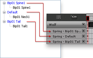

Changing the Name of the Group
By changing the names of the spring groups, you are able to view custom names of the spring tracks in iClone.
In the last step of the previous example, there are three groups in the list; which means the object will be given three spring tracks as you export it into iClone.
To give the tracks some legible names, follow the steps below:
  1. Select one of the blue nodes in the list.
  2. Click the Rename button.
  3. Type in the desired name.
  4. Repeat the steps for the other blue nodes.
  5. Export the object to iClone and the spring track names will be changed to custom names.
