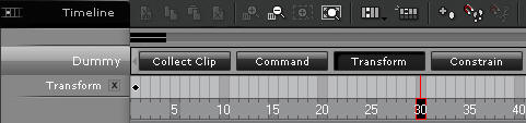

Move the current frame to Frame 30 in the Timeline. Move the segment or Skirt template to generate a moving animation.
Make sure that Preference/Enable Spring/Flex Effect is checked. Play the animation from the very beginning to see the result.

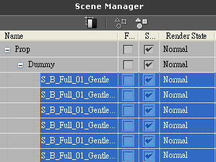

Choose the segment that you want to update from the Scene Manager (Ex. all), and execute Modify/Spring/Import Setting.
