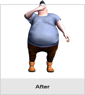

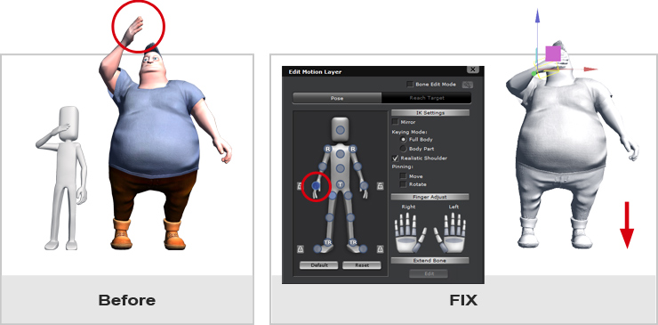

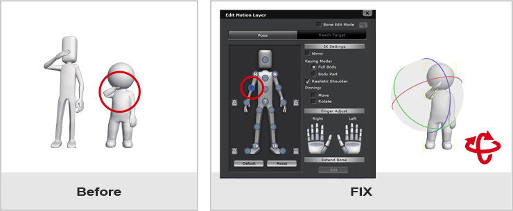

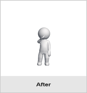

| • Inaccurate Hand Movements Fix-up |
When some motions or gestures, such as Yawning or Headache, are applied to characters in different proportions, then there might be two inaccuracies for character's hand motions.
1. The hand (or arm) is away from where it should be. Just adjust the the hand (or arm) closer. |
| 2. The hand (or arm) penetrates the body or head. Just move or rotate the hand (or arm) to solve the problem. |

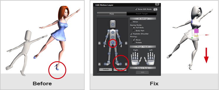

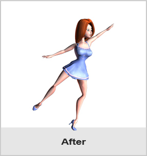

| • Floating Foot Adjustment |
| If some characters have a floating foot while doing certain motions like dancing on tiptoes, then you may just want to pull down the Root or the Foot, to fix this. |
