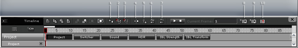

1
Add key
Double-click on the timeline cell area to add keys or press this
button.
Keys can also be automatically added when users alter key information in the
Modify Panel.
The Add Key button only works for the
Transform, Motion Layer, Facial Layer,
Visible, HDR, IBL, and Effect sub tracks,
and all other sub tracks for cameras and lights (Constrain sub tracks are excluded).
2
Zero Transform Key
The Zero Transform Key only works for the Transform track.
Click the Zero Transform Key button to add
a neutralizing key.
This key is used to neutralize all the other transform
keys in the
same track.
3
Reset Pose Key
The Reset Pose Key only works for the Motion Layer track
of Actors.
Click the
Reset Pose Key button to add a key
to disable all prior
Motion Layer Keys in
the same track.
4
Break
Break works for Clip type data in all tracks/groups
except for clips in the SoundTrx group.
Click the Break button to split the selected clip in two at the current frame.
5
Reset Motion Pivot
Reset Motion Pivot button works only for the
Motion track.
When a clip contains motions that offset actors; click on this button to
have the entire motion begin on the same position where the motion starts.
You may store your animations in the library to be used with AML in order to create your own animations.
6
Loop/Speed Switch
The Loop/Speed Switch button works for Clip type data in all tracks/groups
Press the
UP and
drag the clip's right edge rightward/leftward to
decelerate/accelerate the speed.
Press the
DOWN and
drag the clip's right edge rightward to repeat the clip.
7
Motion Reverse
The Motion Reverse feature reverses the data of a clip so you may create back-and-forth motions with only the
forward-motion clip.
8
Delete Frame Option
Click this button to delete a series of selected frames in order to decrease the length of the project.
You may also delete data, within a range, of any object in the current scene without affecting the length of your project.
9
Insert Frame
Click this button to insert a designated number of frames into the current time frame in order to increase the length of the project.
10
Add Flag
You may use this feature to set flags at specific time frames so that you may quickly jump to the frame by using the Tab, and Shift + Tab keys.
