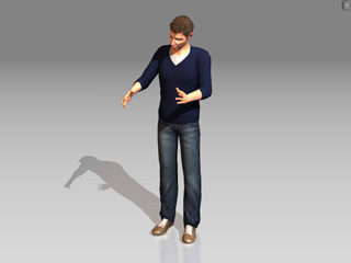

  1. Apply a character and a motion.

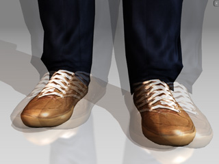

  2. You probably see that the feet are sliding when the character acts

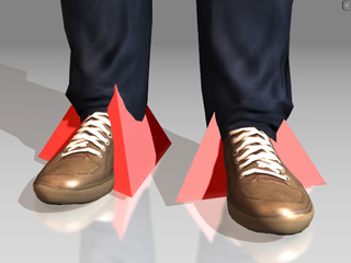

  3. Apply two primitive props (the lower the polygon the better) to the feet of the character. Set them as dummy.
  4. Set the two feet to reach the dummies, and also activate the Reach Object mode.

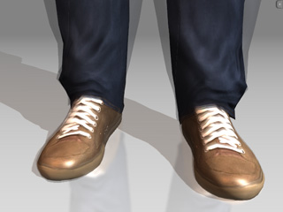

  5. The feet are pinned to the dummies and will not slide anymore.
