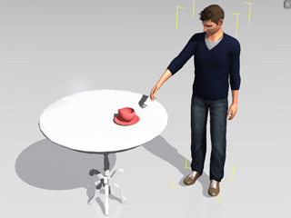

  1. Apply a character and a target object, in this case the coffee cup.
  2. Have the character's right hand point at the coffee cup. Please refer to the Using the Reach Target Panel section for more information.

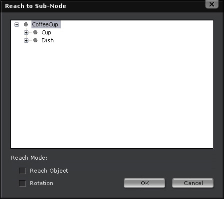

  3. If you wish the hand to contact with the cup, then press the Reach to... button to open the Reach to Sub-Node panel.

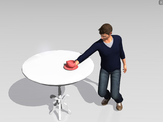

  4. Activate the Reach Object box under the Reach Mode group so that the hand will be snapped and aligned to the pivot of the coffee cup.

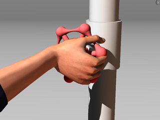

  1. Apply a character and have the character's right hand reach out and touch (Reach Object activated) the target prop.
    • The hand reaches towards the prop.
    • The fingers are adjusted with the Edit Motion Layer panel.

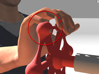

  2. Rotate the prop.
    • The prop rotates.
    • The hand does not rotate, which causes the prop to go through the fingers.
