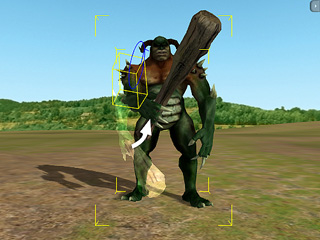

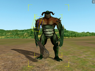

Select Rotate tool in the control bar.

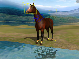

Click on the non-human actor to pick a bone. Alternatively, you may pick a bone by clicking on the node in the tree view in the Edit Motion Layer panel.
Click on the actor to pick the bone. |
Click bone in the panel. |
Drag Left Mouse Button to rotate the selected bone.

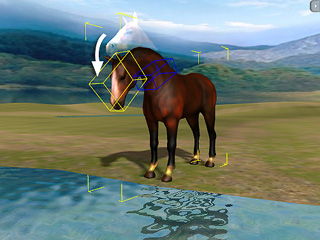

Pick another node to be the end node of the chain. (don't hold Ctrl key)
Ctrl-click to anchor the start of the IK chain. |
Click another bone as the end of the IK chain. |
Drag across the 3D viewer to modify the whole chain with IK control.
