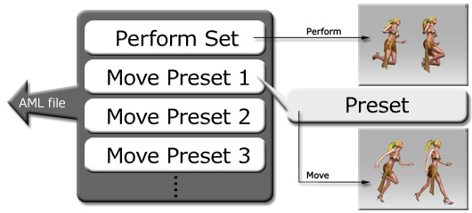

Diagram of the AML file |

Basically, an iClone actor is embedded with several mode presets. In each preset, various Motion Clips for moving forward, backward, left, right or even idle movement are defined.
The definition is saved in an AML file (Animation XML), you may export this file from one iClone actor and then apply it to another iClone actor.
