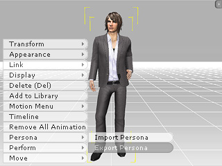

You may export the persona of a specific actor, modify the content of the file and apply it to the original or another actor.
To export a persona, you may:
Right click on the actor and select Persona/Export Persona.
Alternatively, you may go to Actor/Persona/Modify page and click Export Persona button.
