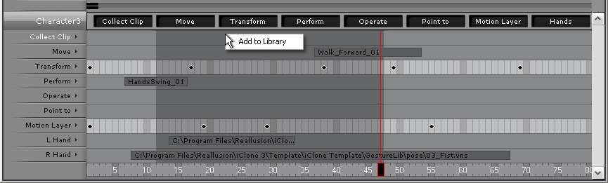

Collect Clip for Actor
  1. Please make sure that some of the tracks (Idle, Move, Transform, Perform, Operate, Motion Layer, Hands) for the actor contain keys or motion clips. If these tracks are empty the motion you generate will be only turn into a default idle motion.
  2. Press the Collect Clip button to show the track, click and drag to include a range in which the desired motion clips or keys exist.
  1. Right-click within the range of the Collect Clip track and select Add to Library. Name the clip.
  2. Browse to a location where you want to save the motion to and click Save button.
All the clips and keys in the tracks listed above will be merged and compacted into a motion file. You may then import it back by right-clicking on the Perform track and selecting the Import command.

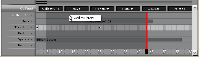

Collect Clip for iProp
  1. Please make sure that some of the tracks (Idle, Move, Transform, Perform, Operate) for the iProp contain keys or motion clips. If these tracks are empty the motion you collect will be completely empty.
  2. Press the Collect Clip button to show the track, click and drag to include a range in which the desired animation clips or keys exist.
  1. Right-click within the range of the Collect Clip track and select Add to Library. Name the clip and click OK.
  2. The animation clip will be embedded to the prop and added to the Perform list.
All the clips and keys in the tracks listed above will be merged and compacted into an animation file. You may then import it back by right-clicking on the Perform track and selecting the Import command.
