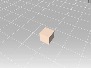

Apply any 3D block to your scene. If you drag a prop into the scene click the Zero Transform Key button on the timeline to set the centralize the object.

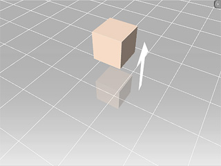

Open the Transform track. There will be one key already in frame 1. Go to frame 20 and move the block up the Z axis to your desired height. You now have a taking off animation ready.

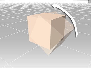

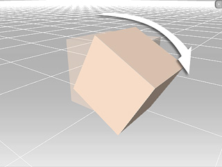

Go to frame 30 and rotate the block along the Y axis. Click Zero Transform Key at frame 40. Now your rotating animation is ready.

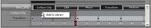

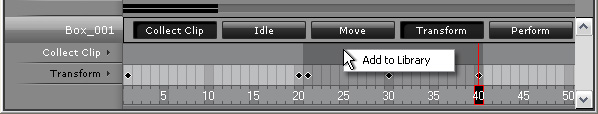

Open the block's Collect Clip track and drag to select a range to include frame 1 and frame 20. Right-click in this range and select Add to Library. Name it as Taking Off.
Drag to select a range to include frame 21 to 40. Right-click in this range and select Add to Library. Name it as Flapping Wings.

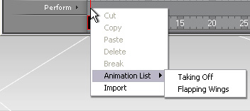

You may examine the recorded clips in the Perform track. Right-click at any frame in this track and browse the Animation List. Optionally, you may right click on this prop in the 3D viewer and look in the Perform entry to see the animation clips.
