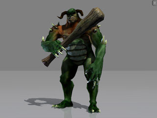

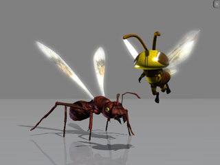

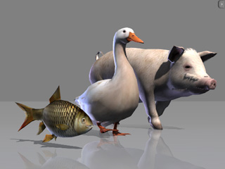

The sources of the static non-human models can be:

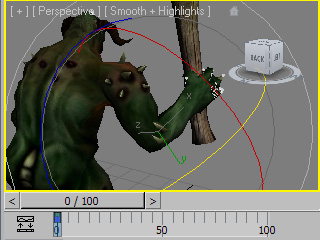

Step 3: Loading and Setting the Key-frame Animations in Maya or 3DS Max
  1. Import the FBX file into Maya or 3DS Max with the settings below:
  2. Adjust the bones to posture the model in different time frames and set keys to the bone structure.
  3. Play back to view the time-frame animation.
