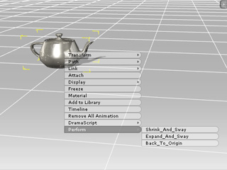

Export (Ctrl + E) the model as an iProp (.iProp).
Load into iClone. Right click on the iProp and all the animation clips you have added will be listed in the Perform entry of the right-click menu.
