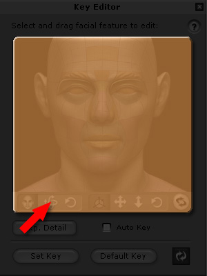

Setting the Transform Keys
Using the Key Editor, you can also set or modify the Move/Scale/Rotation keys for the models.
Including the Move Data into a Key
  1. Select the tool in the pane.
  2. Drag inside the interactive area or click inside the interactive area and drag outward the panel.
  3. The model then moves along with the movement of your mouse.
Initial View
Moves Up
Moves Down
Moves Left
Moves Right
  1. Click the Set Key button to include the changes into the key.
Including the Scale Data into a Key
  2. Drag inside the interactive area.
  3. Scale the model up or down by moving your mouse up or down.
Initial View
Moves Up
Moves Down
Including the Rotate Data into a Key
  3. Move the mouse left to rotate the model counter clock wise and move the mouse right to rotate the model clock wise.
Initial View
Moves Left
Moves Right

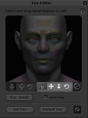

  • Check the Auto Key checkbox so that you don't need to click the Set Key button repetitively. The Key Editor automatically includes the status of each features for each mouse movement.
  • Please refer to Resuming Key and Setting Default Key for more information.
