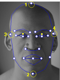

The control point 1, 2, 3 and 4 are the key to control the facial mesh morphing. 1, 2 control the vertical movement strength and 3, 4 controls the horizontal movement strength.
Press Face Profile
Style
on model page and move your mouse
can preview the movement. If not perfect, you can close the dialog and try
to change the location of control point 1-4.
Drag the chin control point
out of the face.

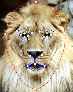

The outline control points should keep to the outside of the facial area.
Select the complete facial outline by clicking
the wire frame, not the control points, of the facial outline. Then use
the
Scale
button to resize the entire facial outline so that it
lies completely outside the subject's face.
Incorrect |
Correct |

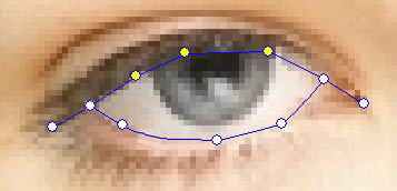

If you are not using virtual eyes, but retaining the eyes in the original picture, move the control points outside the eyelids to create an even more realistic blinking action.
Incorrect |
Correct |

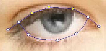

If you are using eyes from the CrazyTalk eye library , you need to set the eye control points inside the eyelids. This improves the realistic quality of the animated eyes.
Incorrect |
Correct |

Control points that are yellow in color indicate that they are the upper control points.
Control points of the eyelid |
Control points of the upper lip |
