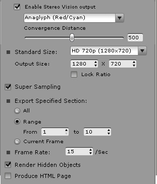

General Output Settings
The general output settings for Video, Image, and/or
Web are described in this section.
Activate the Enable Stereo Vision output to export your project as a 3D stereo media.
The supported formats:
Video: WMV, AVI, MP4 for PC.
Image: BMP, JPG, GIF Animation (The Transparent box
must be deactivated)
Please refer to the Creating a 3D Stereo Project section for more information.
If you are using a virtual Microsoft operating system on a Mac personal computer,
then you may need to enable the Super Sampling box in order to rectify the aliasing issues in exported media.
(Please note that the
Anti-alias in the Preference panel shall be enabled as well.)
Specify the resolution for the output frame by entering the height and width, in
pixels, in the Output Size boxes.
Choose the Range radio button if you only want to export a specific part of the
project.
You may also drag the Mark in/Mark out controls
beneath the play bar (the red triangles in the illustrator below) to specify the range to be exported.
You are also able to export only one image by choosing the Current Frame radio button.
Enter the desired frame rate, in frames per second, in the Frame Rate box.
If you want to export an FLV file for using on a web page, then activate the Produce HTML Page box to
preview the results of your project in a browser. You may copy the code and the flv files onto your web site.
