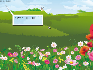

FPS
FPS (Frames Per Second) indicates the rendering performance of your system with the current project.

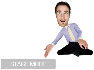

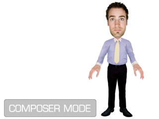

Stage/Composer on screen display
The Stage/Composer On-screen Display may show the mode name at the bottom of the working area to indicate if you are in the Stage or Composer mode.
Stage Mode
Composer Mode

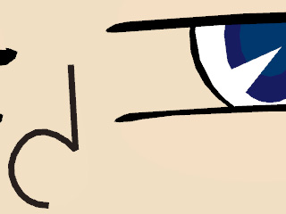

Anti-alias
An anti-aliased output will produce a smooth image with less jagged edges and pixilated areas. Activate the box to turn the Anti-alias feature on.
Anti-alias Off
Anti-alias On
