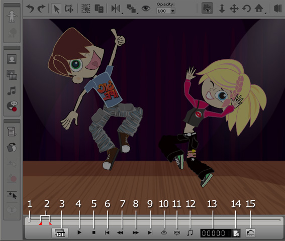

The Play Bar is used to control scene playbacks in CrazyTalk Animator scenes.
1 |
Play Head |
Shows the current frame of the project. You may also quickly drag it to any desired frame. |
2 |
Mark In/Out of Playback/Export Range |
Drag this mark to set the mark in/out frame during playback or export. |
3 |
Bring up the Timeline. |
4 |
Play (Space bar) |
To play back current project. |
5 |
Stop |
To stop play back. |
6 |
Jump to Start Frame |
To jump to the cue frame of the playback, or to the start frame of the project. |
7 |
Previous Frame |
To jump one frame backwards. |
8 |
Next Frame |
To jump one frame forwards. |
9 |
Jump to End Frame |
To jump to the cue-out frame of the playback, or to the end frame of the project. |
10 |
Loop On/Off |
To toggle playback loop on/off. |
11 |
Voice Volume |
To adjust the volume of the sound effect. |
12 |
Music Volume |
To adjust the volume of the background music. |
13 |
Current Time |
To show the current time/frame. |
14 |
Use the Project Setting panel to set the total length of the current project and to show the time unit in the Current Time box. |
15 |
Reset |
Click this to Reset all recorded animation data in the project. |
