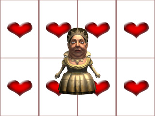

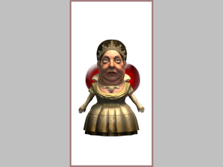

In this section, you may set the background of your project to a solid color or to a prepared image.
button to load any prepared image as the background.
Prepared Image |
Stretched |
Fit |
Tiled 2 X 4 |
