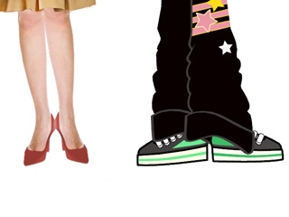

Side and front characters
Front Motion Applied
Side Motion Applied

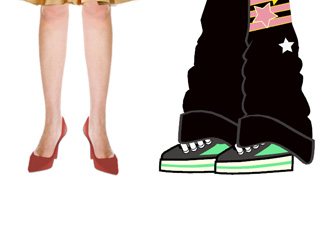

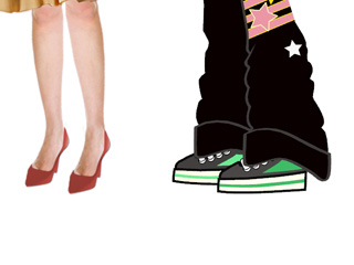

Front and side characters
Side Motion Applied
(Auto-flipping feet for front character)
(Auto-flipping feet for side character)
