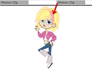

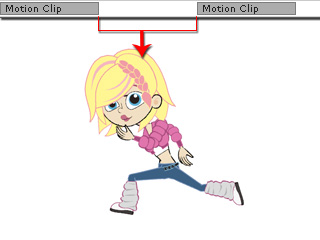

Have two clips applied (Motion clips as example). The illustrations below show the poses of the character at the end, and start, of the
two clips.

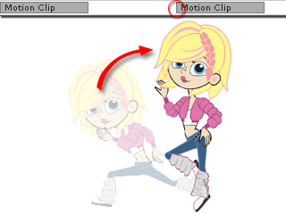

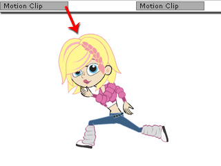

The interval pose of the character remains the same as the last pose of the previous clip. It will suddenly snap back to the pose of the later clip when
the play back meets the start of it (meets later clip).
Still interval pose (without blending)
Snapping to second pose

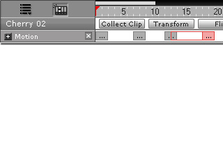

Pick the later clip. The blending part will be shown before the clip.
(Empty rectangle)

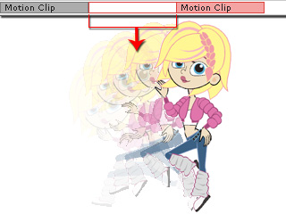

Drag the left edge of it to decide the start timing for the blending
pose.
The character gradually changes the pose during the interval duration.
