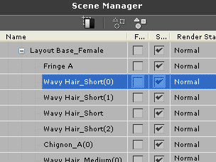

A-1 |
Choose the first Hair Segment from the Scene Manager |
A-2 |
Go to Modify/Adjust Color, and set the value that you want. |
When you see the same type of Hair Segment (Ex.Wavy Hair), but they don't change color together, it mwans that they are not using the same Material. |

Choose the first hair segment from the Scene Manager. |

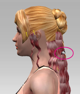

Use hotkey Y to switch to Modify/Material & Texture Setting. |
Click the Paint button. |
Click on every hair segment that didn't change color. |
Through the Paint function, all the hair segments of the same type are using the same material. You can now choose any hair segment and change its color. You will see all the segments will change color at the same time. |
