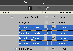

Choose the segment that you want to update from the Scene Manager (Ex. All Wavy Hair Segments), and execute Modify/Spring/Import Setting.
