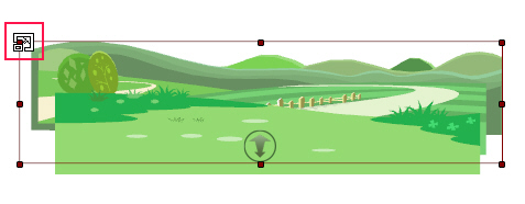

A. Move, Rotate and Scale. |
A-1 |
Apply any Scene in Scene/Scene.(eg. Country_Perspective View) |
A-2 |
Click Scene in Scene Manager, you can select all scene props at once. |
You can scale all scene props at once, when the cursor is on the border of the active objects. |
Tip. You can adjust the scene prop via Transform Tool or drag it in Viewport. |

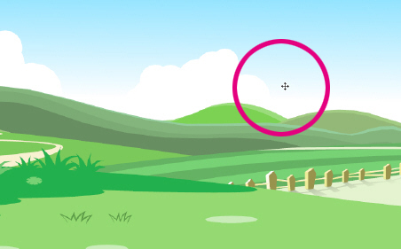

B. Move Camera to test the visual result. |
Crazy Talk Animator provide the space that has depth, and you can see the spaciousness through the moving camera. |
B-1 |
Click Move button, and drag to move camera to left or right. |
B-2 |
You can adjust the Lens value to produce the different perspective of visual effects. |

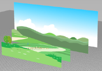

C. Adjust the Z depth of the props. |
In addition to adjust Lens value, you can also adjust the scene prop position individually to produce the different perspective of visual effects. |
C-1 |

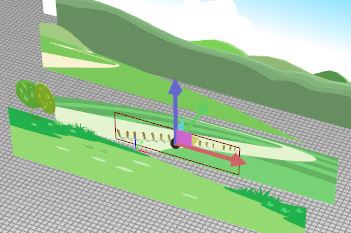

Click 3D View button to enter 3D Mode. |
C-2 |

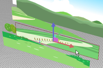

You can drag the Gizmo of Scene Prop to a new position. |
Tip. You can also hold down the Ctrl key, and click more props to move them together in Viewport or Scene Manager. |
C-3 |
When you finish the adjustment, please click 3D View button to exit 3D mode. |
