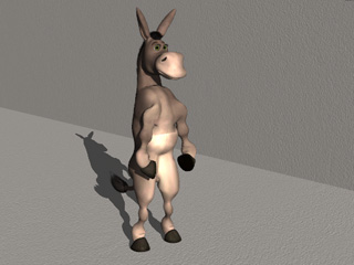

Load a character or a prop with spring effects on specific bones (in this
case, the character has been given spring effects on the ears and the tail
bones).

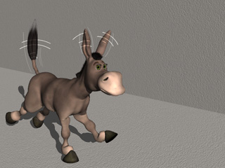

Apply motions to the character, you can see the spring effect triggers the
bones to auto-bounce.

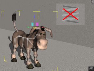

Make sure the character is selected and go to a specific time frame when you
want to turn off the spring effect.
In the Spring section of the Modify panel, select the bones
for which you want to turn the spring effects off via the Select Spring drop-down list.
Press down the Off button.
Go to another time frame, click the On button to turn the spring effect on again.

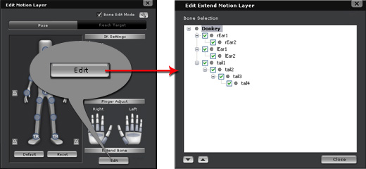

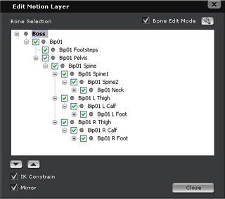

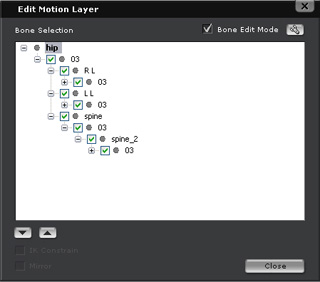

Launch the Edit Motion Layer (for Actors) or the Edit Animation Layer (for Props) panels.
Standard and Non-Standard Actor: Animation >> Motion >> Modify panel >> Adjust Motion section >> Edit Motion Layer button
>> Edit button.
Non-Human Actor: Animation >> Motion >> Modify panel >> Adjust Motion section >> Edit Motion Layer button.
Prop: Set >> Prop >> Modify panel >> Animation section >> Edit Animation Layer button.

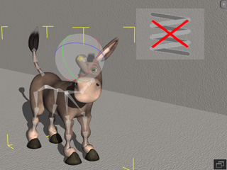

Manually
modify the bones via the IK or FK methods within the time during which the spring effects are off.
IK method.
FK method.
The modification results will be kept in layering keys on the Motion Layer (for Actors) or Animation Layer (for Props) track.
Play back to view the result.
