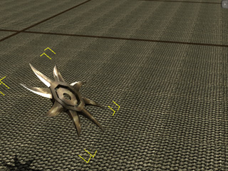

  1. Select the prop that you want it to be a rigid body.
  2. Set it as Kinematic rigid body by selecting the Activate Physics box and press down the Kinematic button in the Object Physics Settings panel (Shortcut: Shift + F9).

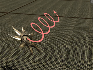

  4. Utilize the prop puppet function to move and/or rotate the Kinematic rigid body.
    The anticipated moving and rotation of the Kinematic rigid body.

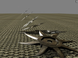

  7. Go to the start frame of the project and play back to simulate. When the rigid body turns to a Dynamic state, the transform keys will form an inertia force, which causes the rigid body to rotate, move and fall.
