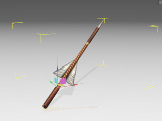

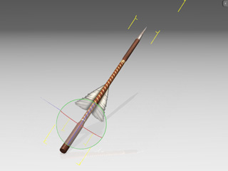

Since the pivot is the base for the transform data to refer to, then the Move, Rotate and Scale work according to the pivots of objects. If a pivot is outside of the model entity, then unexpected results happen, especially Rotate and Scale, when you adjust the transform data of the object.
Move |
Rotate |
Scale |
You might come across models that have eccentric pivots. In iClone, you may freely change the pivot of the selected object without the use of any external software.

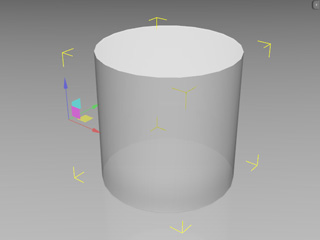

Please select the target prop and toggle the
Gizmo mode (Ctrl + Q) to view the position of
the pivot. And go to the Pivot section in the Modify panel.

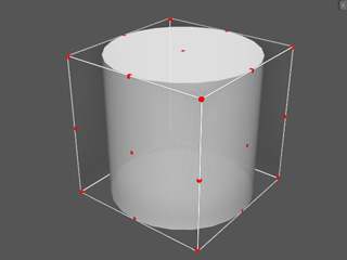

Each prop is surrounded with a bounding box which shows the height, the width and the depth range of the prop.
There are 27 fixed points located on the bounding box for quickly setting the location of the pivot.
Front intersected plane |
Middle intersected plane |
Back intersected plane |

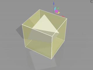

Note: |

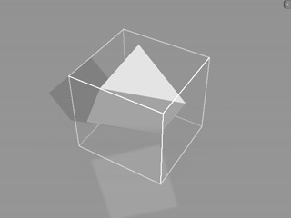

A rotated pyramid and a box surrounding it. |
Back >> Top is set to the pyramid according to the box's orientation. |

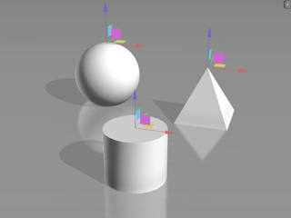

You are allowed to re-assign pivots in multiple props.
