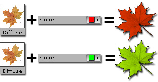

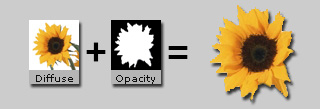

Diffuse - You can change the color or image for each
particle.
Opacity - This parameter decides the shape and
the transparency of your
particles.

Color - Define a color to be blended with the image you load for the particles when they
are generated/eliminated.

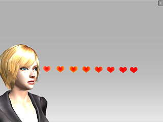

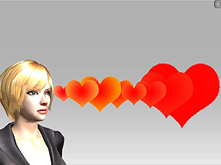

Size
The size of each particle can be modified via the
settings in this group so it transforms gradually and linearly within its
life span.
(10x10) → (10x10) → (10x10) → (10x10)
(10x10) → (50x50) → (20x20) → (80x80)

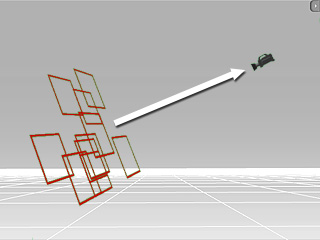

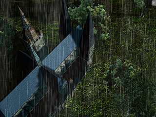

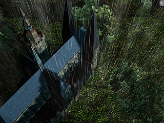

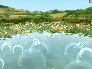

Face to
Basically, each particle is a matted billboard that will be facing the current camera all the time. However,
if you want the camera to view above or beneath the particle, you will need the
Face to feature to get desired result.

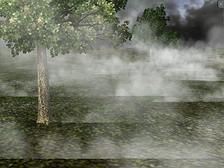

Face Cam: This option is suitable for non-directional particles such as
fire, fog or storm.
Vertical: This option aligns the particles to the Y axis, which is
suitable for vertically directional particles such as raindrops.
Face Cam
Vertical

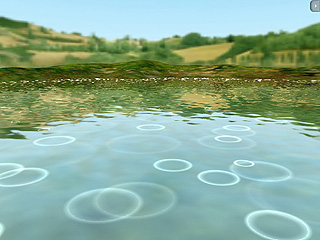

Horizontal: This option aligns the particles to the floor, which
is suitable for horizontally directional particles such as ripples.
Face Cam
Horizontal
