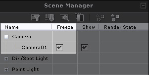

Freeze Camera in Scene Manager
  1. Alternatively, repeat steps 1, 2 and 3 as described above.
  2. In the Scene Manager, activate the Freeze option of the camera.
The camera cannot be picked from within the preview window to prevent accidental transformation.
