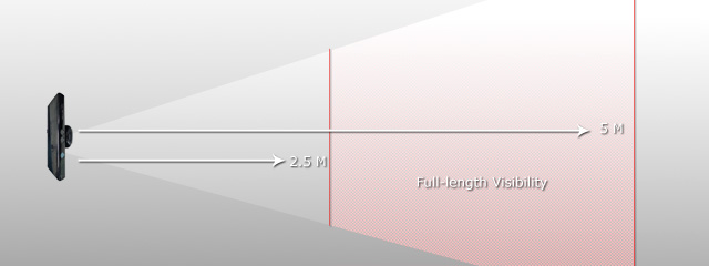

Because of the Microsoft's Kinect Sensor limitations (may be different depending on the brand of the camera),
the optimized capturing range of the camera
is shown below:

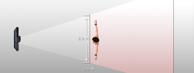

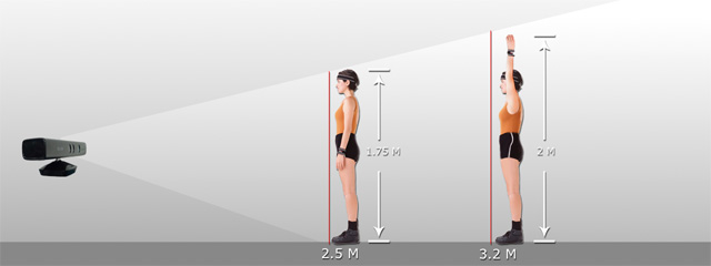

Side view of the Microsoft's Kinect Sensor.
Top view of the Microsoft's Kinect Sensor.

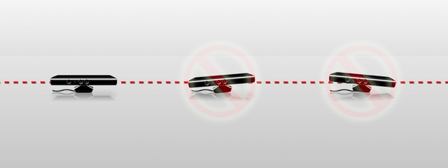

Front view of the Microsoft's Kinect Sensor - Leveling the sensor.
Therefore, the best positions for the Microsoft's Kinect Sensor is to place it in
front of you in higher than 2.5 meters:

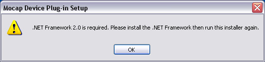

If you encounter the message below, then please go to the
Microsoft download web site to download and install the
.Net Framwork 2.0 (or above) on the computer.
