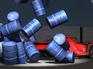

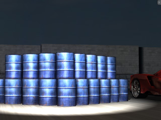

Rigid body
Rigid body dynamics enable you to simulate objects with a high degree of realism such as fall, collide and bounce. All these movements are controlled by physics properties such as mass, elasticity, friction, damping, impulse, collisions, constraints and others. You may even add rigid body physics to any prop or character in order to add another dimension of interactivity between subjects.

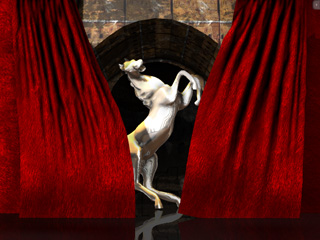

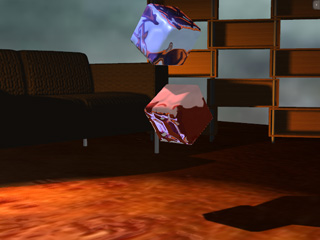

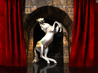

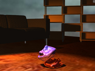

Soft body
Soft body dynamics focus on realistic physical simulations that deform whole objects and singular planes such as clothes. Animations are now incredibly life-like as objects can accurately represent their elastic properties like rubber, squashed balls or jelly puddings. You may even simulate cloth effects, from a singular plane, with different material stiffness such as silk, linen or any other materials that will be affected by air resistance.
