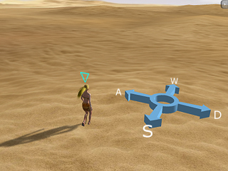

You may use the WASD keys to move your actor just like you would play a computer game.
W: Move Forward
S: Move Backward
A: Turn Left
D: Turn Right
X/Z: Toggle among different modes for moving.
While holding W or S key, press A or D key to turn while walking.
Shift + A: Slide to the Left
Shift + D: Slide to the Right

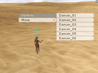

You may use the Number keys (1, 2, 3...) to start the actor's preset animations.
Ctrl + Click Left Mouse Button on the ground to set the target location for the actor to walk to.
Ctrl + Double Click Left Mouse Button on the ground to set the target location for the character to run to.
Ctrl + Click Left Mouse Button on the target object to trigger the default action. E.g. Ctrl + click on a car, the currently selected actor gets into the car.
Click the Right Mouse Button on the target actor to bring up the list of actions available for that character.
